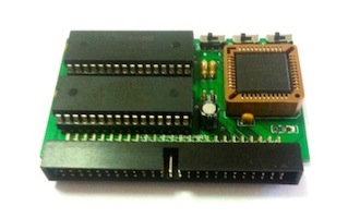

La X-Mem est une extension mémoire développée par TotO. Il en existe deux version, une équipée de 512Ko de RAM et la deuxième de 512Ko de RAM/512 Ko de ROM.
Toutes les informations supplémentaires ainsi que les commandes sont disponibles ici
X-Mem is a memory expansion developped by TotO. Two versions exist. The first one allow 512Ko of Ram and the second one
allow 512Ko RAM/512Ko ROM.
For more informations and order are allowed here

That's a file I have on my computer, it's WIP, but may be helpful for someone...
X-MEM and Y-MEM
The X-Mem provides:
The used Flash Chip is eiter a Winbond or a SST (like in the MegaFlash or FlashGordon)
ROM: 0-31, or
     1-6,8-31, 64=&40 (ROM 0) and 71=&47 (lower ROM)
RAM: $7Fxx (A8=1), 512 KB
The X-MEM with SST Flash is compatible to the FlashGordeon,
except that ROM 0 and 7 must be written in &40 and &47.
The ROM 7 of the FlashGordon becomes the lower ROM of the X-MEM.
To access both expansions the ROMs 2 and 1 must be used.
In case of the MegaFlash it was 0 and 1.
The Y-Mem provides:
ROM: 32-63 = &20-&3F
RAM: $7Exx (A8=0), 512 KB
The CTC-AY provides:
ROM/RAM: 128-255
All expansions use the Winbond W29C040-90B or Z. Or the SST39SF040.
The Winbond W29C040 is also used in the MegaFlash (512 KB FlashROM).
The SST SST39SF040 is also used in the FlashGordon (512 KB FlashROM).
How to check if more then 512 KB ROM is connected?
Compare (part of) the ROM content of &DF07 and &DF47 ...
- A standard CPC with Megaflash/FlashGordon has the BASIC ROM located at position &47.
- But NOT the X-MEM! It has some kind of LOWER ROM at position &47.
On the Y-MEM, you can check with &DF27 too...
X-MEM: ROM &47 contains the LOWER ROM and NOT the BASIC ROM. &DF46 and &DF47 are different.
X-MEM:
The code to program the X-MEM Flash is the same that is used to program the MegaFlash.
The only difference is that instead of using the delay after write a page in the flash,
I use the bit banger protocol that is much faster.
; Bit-banging for waiting to the flash is ready
    PUSH HL
    LD   HL,$C000
loop_wait
    LD   A,(HL)
    CP   (HL)
    JR   NZ,loop_wait
    POP  HL
SDP in X-MEM
To activate or deactivate the Code has to be written to ROMs 2 and 1 respectively.
In case of the MegaFlash it was 0 and 1 respecitvely.
The X-MEM use 3 switches to work:
- ROM lock/free
- ROM boot/noboot
- RAM 464/6128
When you chose to boot from the board, the LOWER and UPPER ROM0 are switched from CPC to the expansion.
All others ROM not changed.
- I use the DFxx bit 6 to know if I read or write a ROM to avoid extra switches (0-63 and 64-127)
  w/o conflict with the internal CPC one.
- The way to flash the UPPER ROM 0 is to write to $40 (=0100 0000, bit 6 is set to 1)
- The way to flash the LOWER ROM is to write to $47 (=0100 0111), bit 6 is set to 1)
  because the lower ROM is physically stored in the unusable ROM 7.
- bit 7 is 0, to not conflict with CPC-AY cartridges where bit 7=1 (128-255)
Y-MEM
Is there an easy way to tell if the Y mem is connected?
1. ROMs &22 (1st 16 KB block in Flash) and &21 (2nd 16 KB Block in Flash)
   can be used to read Manufacturer and Product ID.
2. You will be able to access 512 KB RAM via &7Exx which don't store the same content
   as the 512 KB RAM usually accessible via &7Fxx.
