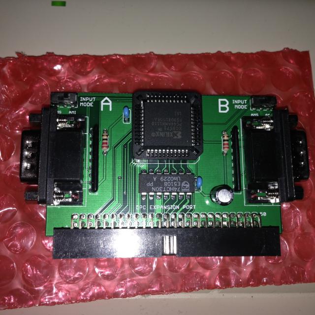

Voici donc ma dernière acquisition, le multiplay.
Cette interface équipée de deux ports db9 permet de brancher une souris type Amiga (position AMI sur l'interrupteur situé sur le port A ou B) ou
deux joysticks supplémentaires (position AMS)
TotO a écrit:
MULTIPLAY V1.5:
PORTS
F990 = Port A Actions bits
F991 = Port B Actions bits
F992 = Port A Mouse POS-X value
F993 = Port A Mouse POS-Y value
F994 = Port B Mouse POS-X value
F995 = Port B Mouse POS-Y value
ACTION BITS
bit0: Up
bit1: Down
bit2: Left
bit3: Right
bit4: 1st fire or LMB
bit5: 2nd fire or RMB
bit6: 3rd fire or MMB
bit7: 0
MOUSE BITS
bit0-2: value
bit3-7: sign (all 0 or 1)
MOUSE RESOLUTION
200 DPI (1 inch move = 200 pixels move)
        ________          ________
A _____|        |________|        |________
            ________          ________
B _________|        |________|        |________
200DPI |1  |2   |3  |4   |5  |6   |7  |8
 50DPI |1                |2
MOUSE ACCURACY
4 bit with sign extended to 8bit (-8 to +7). Mouse register X/Y return the offset since the last read.
Value will saturate if not read for a long time or if the movement is too fast. It will not overflow or wrap.
From a software point of view, just read the port and add its value to your position variable.
- Reading from BASIC with 50Hz interrupt is fine to handle a fast char pointer with acceleration.
- Reading from ASM with 300Hz interrupt is fine to handle a fast pixel pointer with acceleration.
MOUSE NOTE
Proportional Amiga mouse are required to use ports F992 to F995. (switch set on AMI)
Ports F990, F991 are used for the buttons. Other bits will return useless coded quadrature.
Je pense donc bien évidemment l'utiliser pour la nouvelle version d'iMPdraw.
(C'est pour celà que je l'ai acheté, non?)
À suivre....
